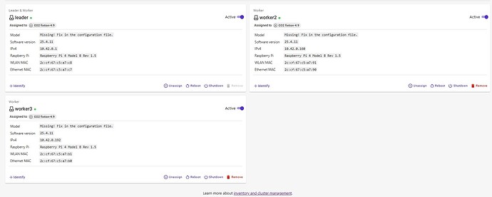

If your UI is 25.4.9, visit your Inventory page, and check the “Model” section there. Is it empty?

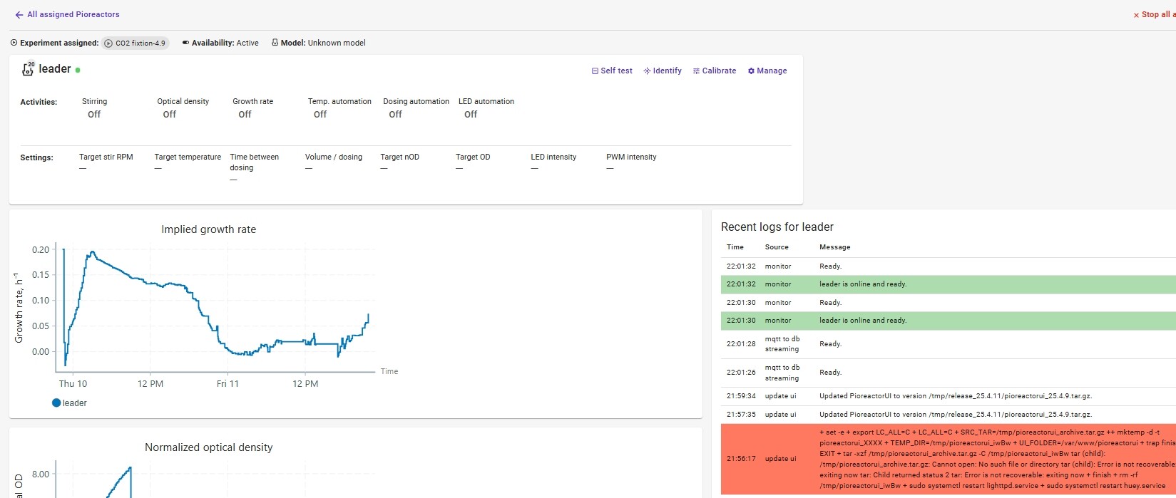

I have see an error during the update.
21:43:57 update app Update failed. See logs.
Model Missing! Fix in the configuration file.
Can you post what the error is? Visit the Leader page, under Inventory, to see the error logs there.
Also, try SSH-ing in your leader, and running:
pio update ui --source /tmp/pioreactorui_archive.tar.gz
or
pio update ui --source /tmp/release_25.4.11/pioreactorui_25.4.9.tar.gz
to update your UI, too.

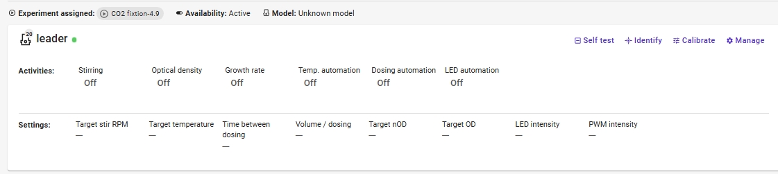

Thank you for your reply. I have updated UI. But I restart my experiment.
All of the activties are off. I can’t start any of them.
Ah, now try the following on the Inventory page:
You should be able to start jobs, etc. after the Model field is populated.
I also can’t see my bottle on my window.
this will be resolved after you populate the Model on the Inventory page.
The update is supposed to automatically populate this “Model” field, but something is going wrong where it is not populating the first time correctly.
