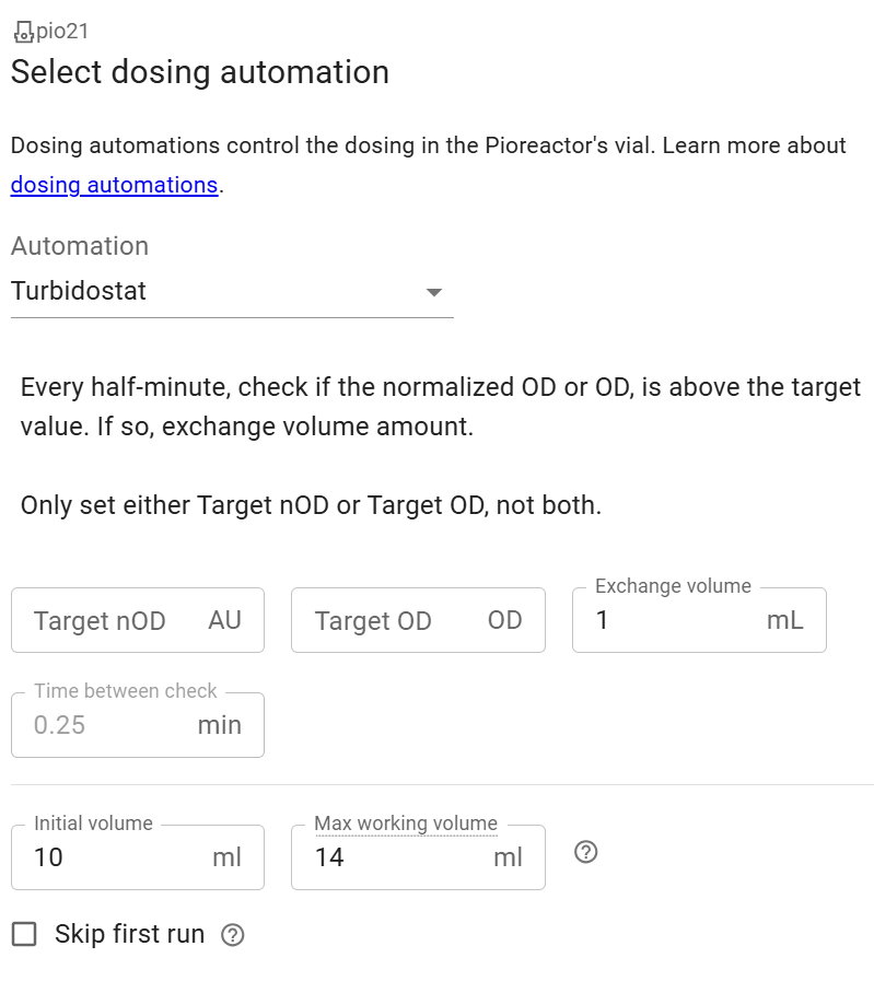

I have a question about the turbidostat settings. In the dosing menu, the Time between check setting is greyed out and set to 0.25 minutes. I can however edit this setting after I have started the turbidostat. Is there a reason for this? It would be more convenient to set it directly at the start.
Ah, that’s a bit of a artifact that we need to fix. I believe even if you tried to edit it afterwards, it wouldn’t update and stay at 0.25.
Okay I see! Good to know, I’ll check it next time.

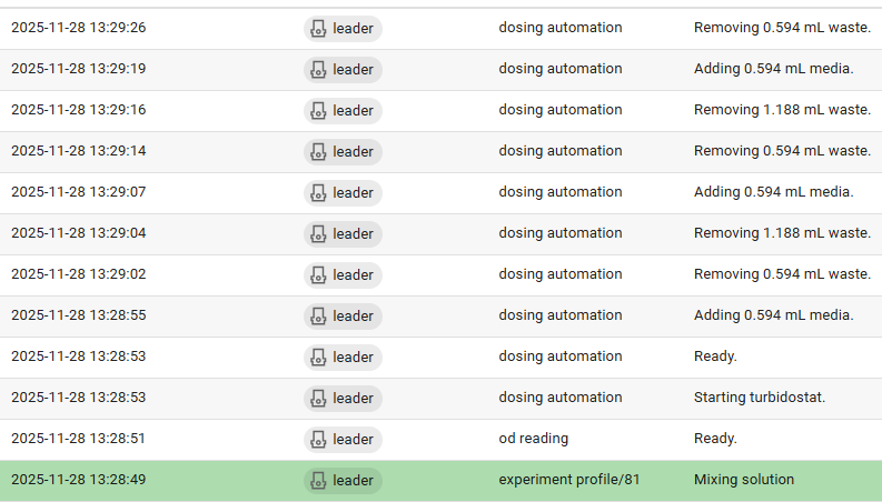

When Turbidostat starts running I notice it removes waste twice every time it adds media. Effectively it’s reducing the vail volume by double the Turbidostat increment every time it cycles. I don’t understand why Turbidostat would ever do that. As Turbidostat continues the UI thinks it has reached the max volume after enough cycles (which makes no sense since the UI seems recognizes it is removing more volume than it’s adding, based on the logs). In reality it has empty the vial (and the last few OD readings are all over the place, above and below target value). See logs for pumping

So there is a very specific reason why for regular operation of a turbidostat (see here), but in your case, you can turn if off by changing waste_removal_multiplier under [dosing_automation.config] to 0.
