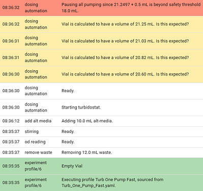

Unfortunately I haven’t been able to test using Turbidostat further because the UI is not recognize any removing of liquid. I tried this but no luck Pioreactor not accounting for removed volume in turbidostat automation and hitting maximal volume and cancelling automation
max working volume = 15
Any suggestions? The only way I can get the UI volume down is rebooting the pioreactor (the manual initiated pumping or volume override in the dosing controls don’t seem to have effect) - Might need a new topic for the issues with the volume tracking
